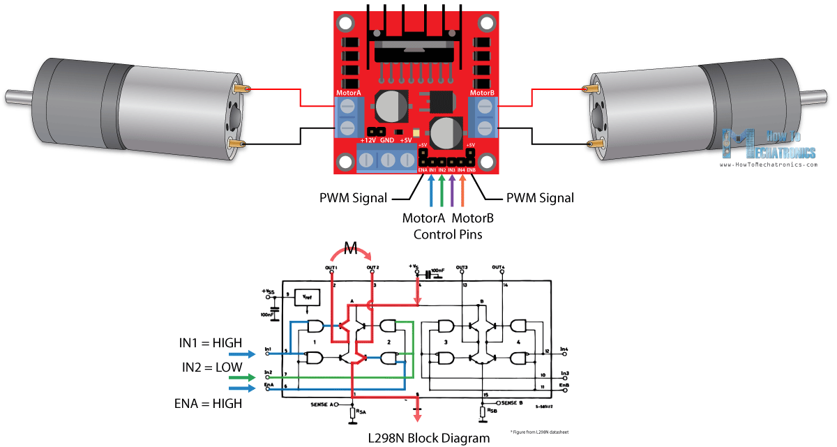

Now I want to try the L298n plug so far only 1 motor, in the application screenshot. The motor hums, hands do not move, but it does not turn. Maybe I'm confused with pins?
The figure shows the order of 2 4 3 5, just tried 2 3 4 5, did not help. What else do I need to configure?
Tell me please.

I believe you have to pull the enable pins high.
